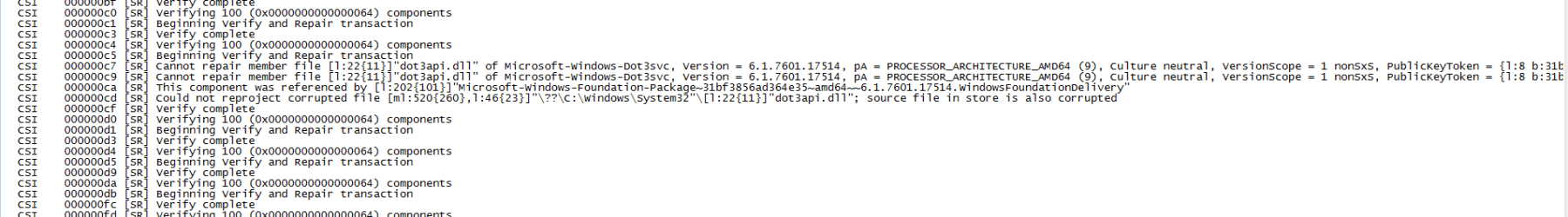

Here are the screenshots from the sfc scan.
HPE Pavillion Elite
I am not sure if your issue is related to that one corruption. But searching for dot3api.dll show it is related to 802.3 and
IEEE 802.3 is a working group and a collection of IEEE standards produced by the working group defining the physical layer and data link layer's media access control (MAC) of wired Ethernet. This is generally a local area network technology with some wide area network applications.
So likely it is, I will PM our expert on this issue once CBS.zip is uploaded. But also need you to attach CBS.log as described in http://www.sevenforums.com/windows-...4840-windows-update-posting-instructions.html #4 (log collection).

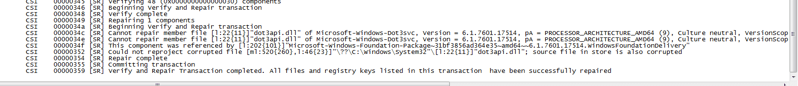

Here's the critical bits from the SFC scan...
	Line 9203: 2015-08-01 19:46:37, Info                  CSI    00000349 [SR] Repairing 1 components
	Line 9204: 2015-08-01 19:46:37, Info                  CSI    0000034a [SR] Beginning Verify and Repair transaction
	Line 9207: 2015-08-01 19:46:37, Info                  CSI    0000034c [SR] Cannot repair member file [l:22{11}]"dot3api.dll" of Microsoft-Windows-Dot3svc, Version = 6.1.7601.17514, pA = PROCESSOR_ARCHITECTURE_AMD64 (9), Culture neutral, VersionScope = 1 nonSxS, PublicKeyToken = {l:8 b:31bf3856ad364e35}, Type neutral, TypeName neutral, PublicKey neutral in the store, hash mismatch
	Line 9210: 2015-08-01 19:46:38, Info                  CSI    0000034e [SR] Cannot repair member file [l:22{11}]"dot3api.dll" of Microsoft-Windows-Dot3svc, Version = 6.1.7601.17514, pA = PROCESSOR_ARCHITECTURE_AMD64 (9), Culture neutral, VersionScope = 1 nonSxS, PublicKeyToken = {l:8 b:31bf3856ad364e35}, Type neutral, TypeName neutral, PublicKey neutral in the store, hash mismatch

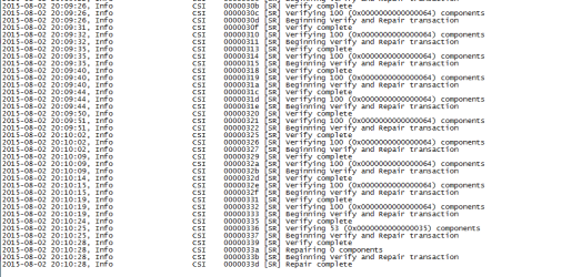

I carried out the operations and everything works perfectly now! My network connections are in the folder, everything that was wrong is fixed!
Heres the screenshots of the sfc scan:
Im pretty sure my problem is solved. Thank you so much Noel for your help, you are a GOD!
