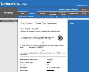

Router 1
Linksys Connected to the cable modem
It's setup as an access point
Ip address 192.168.1.1
Subnet mask 225.255.255.0
See Attached Router 1_setup and Router_1_wireless

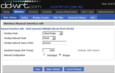

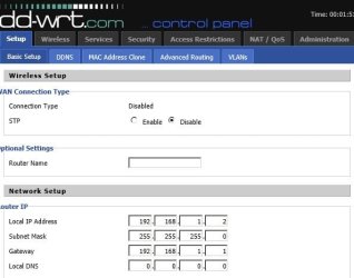

Router 2
Linksys router with dd-wrt connected wirelessly using wireless mode client bridge
Router address is as follows
Local ip address 192.168.1.2
Gateway 192.168.1.1
See Attached Router 2_setup and Router 2_wireless

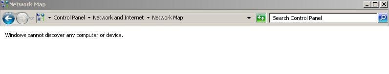

As I stated above , the internet works on this computer I can’t see any other device (computer) on the network. Note other devices connect to router 1 since it’s an access port wirelesly like a IPAD 2 and Two Laptop and wireless Camera. I cant see anything them from the computer on router 2
I also attached a picture of network sharing showing no devices also with a picture of network infomation of my IPAD 2 on the same network connecting to router 1 access point and still can see and devices.

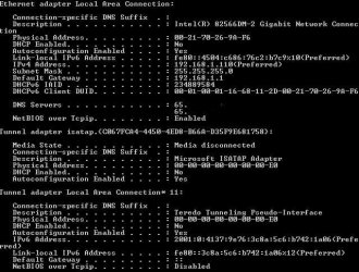

Lastly I added a picture of my ipconfig/all for the computer connected to router 2

Router 1
Gateway 192.168.1.1
