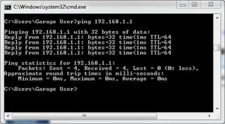

In our case, when we ping either a known IP address or a domain name, we are sending a special packet of info called an ICMP (Internet Control Message Protocol) packet. These ICMP PING packets get to that IP or domanin name and ask for a reply packet to be sent back to the source (our PC)as in this example:
Notice how I get a reflection, or response, from the other IP above (my router).

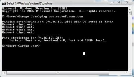

Manytimes when we ping a domain name we can see this:
This lack of a reply above is usually due to a router, server, or firewall in stealth mode blocking these PING replies. There are many reasons why companies and users might want their PCs, routers, or networks hidden from view. Mostly the Hack/Crack/Attack factor...

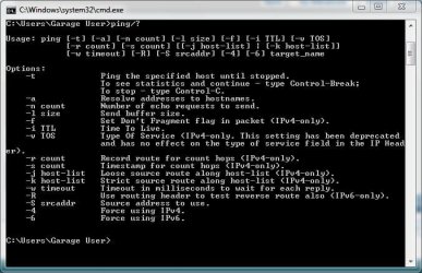

To learn more about ping related commands you can type PING/HELP or PING/? to see all the variables (switches) to that command as I have here:

Really a good idea and nicely presented.
"Attachment 62767
This lack of a reply above is usually due to a router or server blocking these PING replies."
You could add here that this is what a firewall's stealth mode does.

Good suggestion... and thx 4 rep!
Now if I could figure out whats wrong with the images... <-- Fixed!
