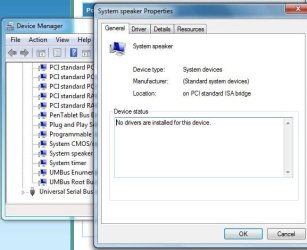

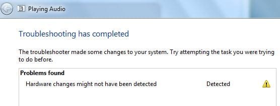

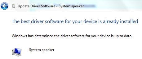

I've searched the forums for topics related to this and none seem to be able to help. In a nutshell, my sound isn't working properly. For the past few weeks the sound has been mostly non-existent. An "x" in a circle sits above my speaker icon, and it says "No Audio Output Device is installed." On rare occasions when I turn my laptop on, the sound has mysteriously resumed working. But as soon as my computer Sleeps or Hibernates, the sound is out again indefinitely. Any idea what I should do?
So you know, I'm running Windows 7 Home Premium 64 bit. My laptop is an HP Pavilion Entertainment PC, dv2500 series. I've tried the whole install new driver thing with the Device Manager, but it tells me all drivers are up to date. I've uploaded a few screenshots so you guys can see.

Just was at HP's site... strange experience. In your system's spec sheet, the only hardware they list for your sound is Altec Lansing speakers. :shock: Conspicuously absent is the audio chip. I can't find any software for 7; however, looking through 64-bit Vista drivers I found you have the Conexant High-Def Audio chip (not familiar with it).
Do you happen to have any drivers similar? Conexant High-Definition SmartAudio 221 Driver HP Pavilion dv2945se Entertainment Notebook PC - HP Customer Care (United States - English)
You don't need speaker drivers... you need drivers for the audio chip. That's why nothing is showing up under playback devices. Something strange is going on though, that's for sure. I've never heard of playback devices just up and disappearing.

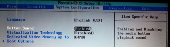

I powered it down, waited the 2 mins, and booted up into the bios as you recommended. I discovered that the Button Sound in the System Configuration (the only thing I could find that related to the audio) was Enabled, as you can see in the snapshot I've provided. Surprise, surprise, though, when I booted up my computer, the sound is now working! There is no longer an "x" over the sound icon that tells me "No Audio Output Device is installed." As you can see, I checked the Playback Devices dialog box and there are now two items listed where the used to be none.
But I'm not entirely sure what to make of this, since the sound was already enabled when I entered the bios. I'm afraid this may just be one of those rare occasions I described earlier, and as soon as I enter sleep or hibernation mode the sound will be gone again indefinitely.
