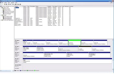

I have an older AMD 4400+ system with some HD's laid out like you see in the attachment. Previously, I was just running the Windows XP x64 which is currently located on Disk 1, second partion (150GB). I also have an install of Linux on located on Disk 0, third partition (35GB), but I have not been using it since my GRUB install got messed up and I have no way to select that OS during boot-up.
Tonight I installed Windows 7 x64 (Custom Install), onto Disk 3. From what I read, during the install Windows 7 should have seen my other OS's and created a BCD menu for them during the install process. It did not. The situation I have now is that when I remove the Windows 7 install DVD from the DVD drive, Windows XP 64 boots up like it did before, but there's no option to boot Windows 7. If I have the Windows 7 install DVD in the DVD drive, then Windows 7 boots up normally, but with no option to boot any other OS.
Any idea how I can fix this without screwing up my Windows XP64 install? I know I can try the repair option with Windows 7 but I'm concerned that it will just overwrite the boot sector to just boot Windows 7 without taking into consideration the Windows XP64 install (which I can't afford to lose quite just yet.)
I tried running EasyBCD in Windows XP x64 as this OS boots up by default if no Win7 DVD is in the drive but it give me an error message stating:
EasyBCD has detected that your BCD boot data and MBR are either not from the latest version of Windows Vista, or don't yet exist.
If you'd like EasyBCD to correct these issues, press OK. This will modify the MBR and requires that you have Windows Vista installed on this machine.
Since I do not have Windows Vista I canceled.
Please advise.

Thanks for the feedback. I thought it would also be helpful to include the drive information from the PC's BIOS. Currently the HD boot order is:
1> SATA1 (Disk 0)
2> SATA2 (Disk 1)
3> Ch. 0 Master (Disk 2)
4> SATA3 (Disk 3)
If I re-arrange the boot order so SATA3 (Drive with Windows 7) boots first, then I get the following error:
DISK BOOT FAILURE, INSERT SYSTEM DISK AND PRESS EJTER
Yes, it actually says "EJTER", :sarc:.
This to me implies that the BCD loader was not installed on the drive that Windows 7 is on.
Just to clarify, GRUB is not present on SATA3, and is currently not being used at all. When I boot the computer normally (without the Windows 7 DVD in the drive) it boots right into Win XP. In the future, I plan to run Ubuntu on a virtual machine, so I think I'd rather avoid re-installing GRUB at this time.

wee has made a valid point here. I am unable to read the screen shot you posted clearly and would think a more detailed screen shot will be of great assistance in advising you. If you could crop the image before attaching it, or if necessary, temporarily reduce your screen resolution when you take the screen shot to allow for more detail?
What I can see is for example 8 partitions on Drive 0, 5 partitions on drive 1, 4 partitions on drive 2, and one partition on drive 3. As you may perhaps already know, Windows limits primary partitions to ONLY 4 on a single hard drive, so without the detailed info from a readable screen shot, what is going on here?

First off, thanks again for your help. Sorry about the original screenshot... I cropped it with MS Paint and for some reason it added a lot of white space. I have included, hopefully, a clearer representation.
