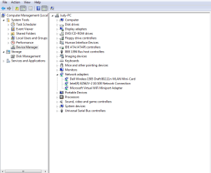

i guess when you say you upgrade from xp you have a windows 7 disk that you installed windows 7 with as their is no upgrade path from xp to win 7. can you post a screen shot of the device manager with the network group expanded.

my blue there, actually upgraded from Vista. Had to activate only W7, others were automatic. Windows install had me remove disk and allow all Vista updates before I could continue.
Attempting to setup new broadband connection brings up error 651.
Device manager image and command prompt printout attached.
