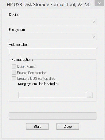

Try formatting it with HP USB Disk Storage Format Tool v2.2.3
HP USB Disk Storage Format Tool Download - Softpedia
( Right click on HPUSBDisk.exe and Run as administrator. Please remove all other external drives/flash drives so that you do not accidentally format a wrong drive. Please be aware that formatting will not destroy the data, but will make data recovery difficult if not impossible provided your drive is good)

The device itself is not shown(recognised). Your HDD may be beyond resurrection. If it is under warranty RMA it.
