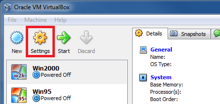

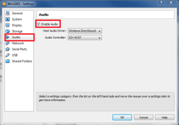

Is there a way to disable devices in VirtualBox. I think this is the audio card. I don't need audio.

Here:
