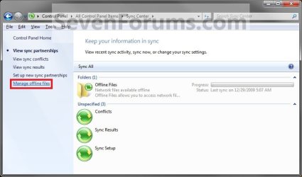

1. Open the Control Panel (icons view) in Windows 7 or Windows 8, and click/tap on the Sync Center icon.
2. In the left pane, click/tap on the Manage offline files link. (see screenshot below)

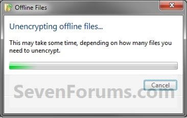

A) Click/tap on the Encryption tab, Unencypt button, and on OK. (see screenshot below)
B) You will see this for a moment while the offline files are being unencrypted. (see screenshot below)

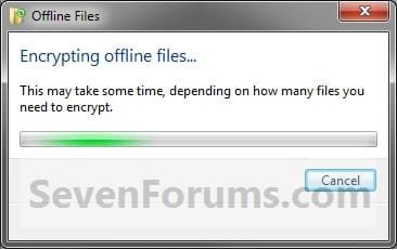

A) Click/tap on the Encryption tab, Encrypt button, and on OK. (see screenshot below)
B) You will see this for a moment while the offline files are being encrypted. (see screenshot below)

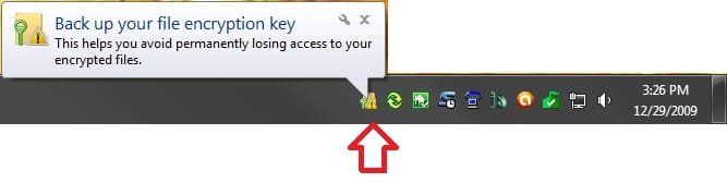

C) If this is the first time that you have encrypted a folder on your computer, then you will also now see this in your notification area to let you know that you should Back up your file encryption key. (see screenshot below)

A) Click/tap on the notification icon from step 4C above to open it. (see screenshot below)

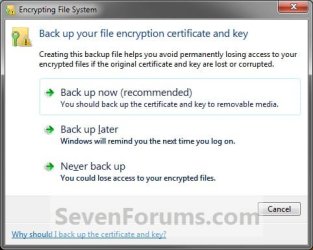

B) Click/tap on Back up now. (see screenshot below)
NOTE: If you click on Back up later, you will see the notification icon above displayed again the next time you log on to remind you to back up the encryption key again.
