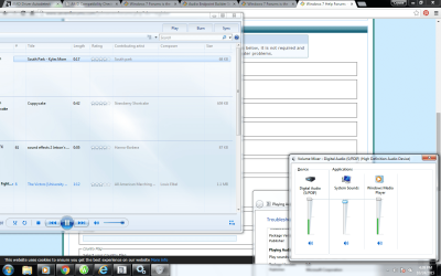

OK.. I can not get sound. I have read all the posts about "audio service isnt running". I do not get a error code. I have checked services under windows audio and audio out. They are started and on automatic. When I open the windows audio, it shows no dependencies. On the audio out, it does. I have updated all drivers from the manufactures sites.
I have uninstalled the drivers and reinstalled them. Didnt help.

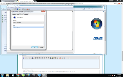

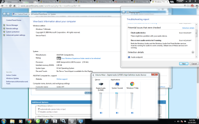

When I try to run audio, it shows that it is working on the volume control.(see screenshot)

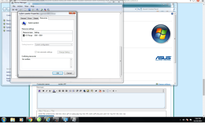

There are no error codes, or problems when I open the Device manager.(see screenshot)

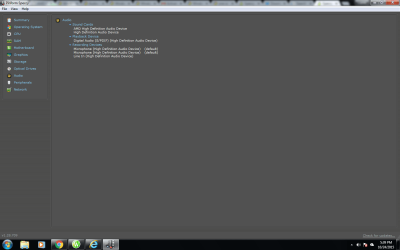

I am sending a few screen shots.
I have a Desktop ASUSTEK computer. (see screenshot)
Any help would be awesome.

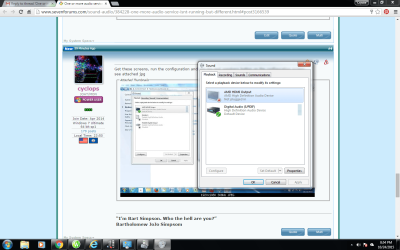

Are the speakers powered on? Can you do the configuration settings for the speakers and try the test speaker function?

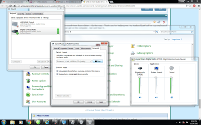

they are on. Ill send you a screen shot
Arizona
Arizona
GOOGLE
Get these screens, run the configuration and use the test speakers button on the configuration screen.

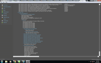

It wont let me configure . Here is what I get ill send you a screenshot It said something is unplugged??.

OK, now make sure you are plugged into the correct place on the computer and if yo have one try a different cable. The computer likely detects when a device is plugged in. Try a set of head phones like from a mp3 player in the headphone jack. Let's keep this simple, you've already gone to deep with the driver and all.

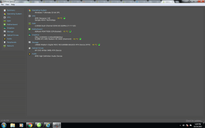

as you cab see the computer is picking up the sound see attached screen shot. The level is all the way up when I hit test.
Arizona
Arizona
GOOGLE
As I said that is for a fiber optic or digital coax type connection for a High Def receiver or similar device. That is only displaying what is detected internally, not going to you speaker or head phone jacks
S/PDIF (Sony/Philips Digital Interface Format) is a type of digital audio interconnect used in consumer audio equipment to output audio over reasonably short distances. The signal is transmitted over either a coaxial cable with RCA connectors or a fibre optic cable with TOSLINK connectors.
You need to figure out how to add your analog connections to the configuration screen

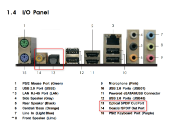

What you have selected as a default should be plugged into one of these,
If you look at the properties it shows you the jacks,

You need to be configuring so that the HDMI Audio Output device shows like this picture

smilecj777, you are probably using regular speaker cables and if it's like my simple 2 speaker set up it's the green connector
