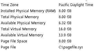

@GENEO I am refering to standby ram i guess you didn't get that windows will always hold back some sort of ram some chipsets allow the usage or the idea of all ram is being used
Noone said about it being a boost it is there for when a demanding application ask for it and since you never heard of it let me show you since im not useing anything but just replying to this thread i have no usage at all pretty much and when i use something that needs that much ram to run it will be used out of the standby portion that is held back
If you never of heard of this it is obvious you don't know what is going on with windows
sorry but i just showed you and right there makes up all 8 gigs of my ram just saying
by the way my chipset supports 16 gigs so that isnt why

I hope what i am saying to you all makes sense I am useing 8 gigs of ram and usable is only 6.75 so i am missing 1.25 gigs which is allocated in standby waiting for the day i have a program that needs it
Then there is a setting wrong somewhere (bios, msconfig, wherever) because according to the specs for your motherboard,
BIOSTAR :: TA785GE 128M :: Specification
it supports up to 16 GB of ram, so if everything is configured properly you should have all 8 GB available.
Edit: And looking at that screen shot you posted you do have all 8 GB available, so I don't see where you're getting that there is 1.25 GB missing (or being held back as you put it).

it is configured properly am i am running 64 i been over this with many unless im useing programs that need it i wont ever max the ram out

I too would like to know why you think you're "missing" 1.25GB. Your snip shows all 8GB!

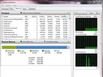

those i was useing as a example if you look into system informantion it shows how much ram you are actually using vs what is installed that is what im talking about technicly im not missing a thing it is the numbers that show im not using all 8 gigs thats my whole point not that i dont have it all installed it is showing it's not using it all

lol...the "Available Physical Memory" is minus what is in use!

exactly
Then why did you say this??? :confused:
It's not "missing" or "allocated in standby"...It's in use!
