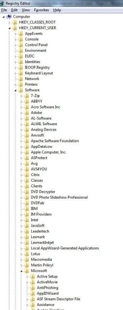

I am not familar with proxy or how to get to that location.
7
Go Start > type in the search box "regedit" (without the quotes), then hit Enter. This will bring up your registry editor.
Then you just follow the directory and drill down to the location.

Found it thanks. Yes there is a proxyserver key, or at least there is a long string for the data value. What does that mean?
Thanks for the help
7
It could mean you have a proxy server looking after your internet connections. Right click on the Proxyserver key, rename, and name it as OLDProxyserverOLD. That way you won't have no proxyserver entries, and you can change it back should you need to.

By proxyserver key, I meant that there something on that list that says "ProxyServer" and that the data value is very long. There isn't something called "ProxyServer key" if that was what you were referring to.
Is that what you meant. Sorry for having you spoonfeed this to me, lol.
7
ProxyServer entry. I refer to the entries as keys. The very long data value is a value know by the system only, a hash if you like.

Yes, I just renamed it to what you said.
Since I am not exactly sure what we are doing, let me just reiterate that while on 2 different wifi networks, no program including windows can access the internet except FF. However, when I tether on my iPhone using iPhoneModem, all programs and windows connect to the internet fine.
