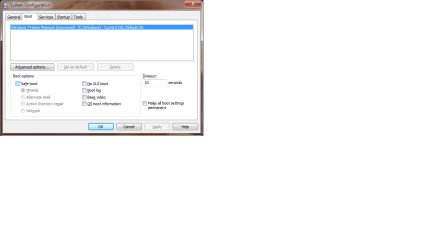

Many thanks for your replies,
I have run EasyBCD and now its showing again as in the below image.
