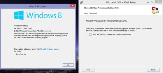

Have you worked any with Windows 8? I was just curious if MS Office 2003 was going to be compatible for that. Do you know?

In case you missed it, 2003 will install to Windows 7. ;)
That's an idea, I'm booted to Windows 8 right now, let me see what I have for install media, I'll post back here. ;)

Here you go mate! ;)
