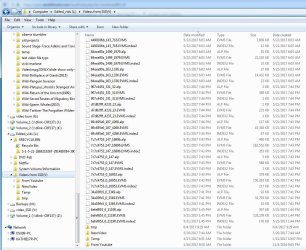

I turn on my PC this morning with Win 7 Pro 64bit and the L partition on the 2Tb HD has completed destroyed hundreds of video MPG files and turned them into the following:
https://www.sevenforums.com/attachment.php?attachmentid=399218&stc=1&d=1496602693
I tried to find events in the event viewer and came up with some that look like this under the security tab
Code Integrity determined that the page hashes of an image file are not valid. The file could be improperly signed without page hashes or corrupt due to unauthorized modification. The invalid hashes could indicate a potential disk device error.
File Name: \Device\HarddiskVolume3\Windows\System32\sxs.dll
Anyone know what that means?

I haven't because none of them are they typical size of the files I generate - 3.2 Gb - 4.3Gb These are all much smaller and resemble nothing that was in this folder "Videos from SSD(V)" last night

I spent the entire day recreating the MP2 files from the Studio 20 folders saving them all to the folder with the garbage. An hour ago I looked and there were at least 30 files of approx 1.6Gb size each. Now there is NOTHING, but the 374 files of jibberish. WHAT IS GOING ON?
I imported two of the first ones on the list and they are included below. NOT readable by me.

TONIGHT I HAVE DISCOVERED THAT WHEN STUDIO 20 ULITIMATE IS CLOSED ALL THE EXPORTED FILES TO MY L:drive into the folder name "Videos from SSD(V)", end up being deleted. Some how in the Studio 20 setup screen where all the other file locations were set to C:\***** the render location was the place on the L drive. So upon closing Studio it cleaned the folder out with the exception of those unreadable files. I moved it back to the C:\ drive and now I can start saving the MP2 files again. I have no idea why Studio thought to grab that drive/folder - I certainly did not change it since I wasn't even familar with the setup panel - I had been using it the way it installed!!!
So I guess I now know what happened to all my files in that L: folder location - must have been last night when it went crazy
