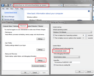

Make sure you do not have "Automatically Restart" checked in your System Properties (see Screen Print).
If Windows crashes, you probably will see a BSOD if "Automatically Restart" is not checked.

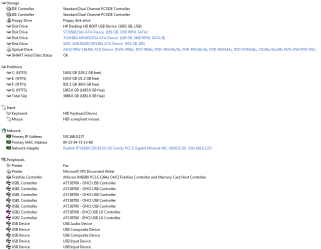

I can't run that file because I get that error message I posted up before, however I do have Everest and I've taken a few screenshots, best I could do, sorry.

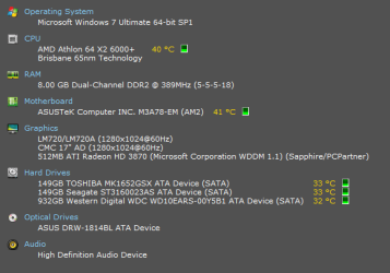

Here's a snapshot from speccy

I'm not sure I understand what the automatic restart has to do with it. When it happens I don't get a blue screen or anything, it just turns off as if I've held down the power button.
You won't see the blue screen if there is a BSOD and you have "Automatically Restart" set.

Oh ok, I've stopped the automatic restart. It hasn't happen again yet, but when it does, do I write down an error code or something?
Windows 7 Ultimate 64bit
The next time it happens let us know if you do see a BSOD blue screen, and we'll go from there.
This setting change is just trying to determine if you are getting a BSOD and don't know it.
