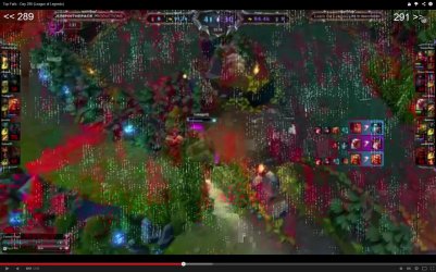

Hello guys from yesterday i have a problem at my screen . All the times green squareds shown in my screen and when videos (youtube) playing they are destroyed with many colors. just check the 2 attachments i cant describe more.????? ?????2.jpg
Windows 7 ultimate 32bit
there 2 issues that are most common causes of things like this.
1) is a faulty ram stick. simplest way to check that if you have more than 1 stick is to remove one and then see if the issue occurs. if it does, replace it and remove the other one. if that cures it, you have found the issue, if it doesnt, try cleaning the ram with a can of compressed air as well as the ram slots. and test again.
2) if none of that works then its a gpu fault, again more thsn likely faulty ram on the gpu. heat could cause artifacts so check gpu temperatures.

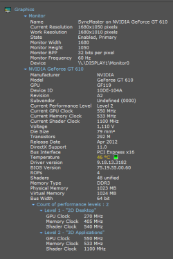

This is yesterday print screen , temperature was 46 , today is 43 , it is normal?
yeah thats well within thermal limits. most gpus have a thermal limit of about 90c. my 770 happily sits at 87c under full load when playing games for hours.
