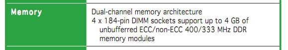

Welcome to SevenForums: You can download your manual from Asus site. Your board requires 184 pin DDR memory http://support.asus.com/download/download.aspx?SLanguage=en-us If you read through the memory section it will tell you which slots to use. Page 1.7 / 1.7.1 System Memory Overview/ 1.7.2 will explain memory configuration and what slots to use. (When downloading the manuals I used china as the global site always has to much traffic to download and the other is P2P.
Also on the manual page( I used Vista 32bit for your OS search) since it is the closest to Windows Seven you can also download the manufactures A8N-VM CSM Memory QVL which is what the Asus manufacture has listed as qualified memory modules for your board http://support.asus.com/download/download.aspx?SLanguage=en-us
I believe your board uses the AMI bios so that would be the beep codes you would be looking for.
