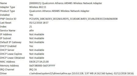

Hi Luiz,
something odd here, according to
msinfo>> components>> Network >> adapter
its using AR5005g drivers and there's no set-up detail (obviously why it wont connect)
see screenshot
Your Ethernet looks fine.
compare the details they should be the same - IP/subnet the only difference will be (xx) 192.168.0. XX
ignore MAC
In your position i would disconnect the card - remove drivers AND if it gives you remove Device option DO IT
REBOOT
re-insert the card and let the OS prompt for drivers
Roy

Hi Roy,
I have installed and uninstalled the drivers many times, always deleting the previous driver. I have also moved the adapter to another PCIe slot.
Under device manager – properties, all three installs says that the Device is working Properly.
To get an IP/subnet you must choose a router and logon on it. The problem is that windows says that there is no Wi-Fi and there are at least 4 around.
The adapter isn't the AR5005G, it is the AR9485. It is also on msinfo >> components >> Network >> adapter

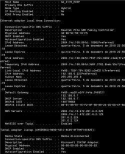

IpConfig /all doesn't show the Wireless adapter

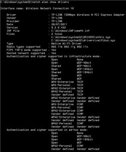

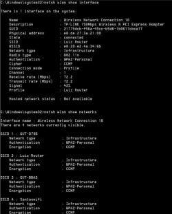

netsh wlan show drivers
netsh wlan show interface
netsh wlan show networks
what results do you receive?
Windows 7 x64, Vista x64, 8.1 smartphoneIntel E8400 65W 64-bitDDR2 2 x 2GB, 1GB x 2XFX Radeon HD5750
Gigabyte EP45-UD3LR
XFX Radeon HD5750
AMD High Definition Audio; Realtek High Definition Audio
iiyama prolite X2377HDS
500GB 7200 rpm Seagate ST3500413AS 16MB, 500GB 5400 rpm Toshiba MQ02ABF050H 32MB, 200GB 7200 rpm Seagate ST3200820AS 8MB, 2TB 7200 rpm Western Digital WD20EZRX 64MB
Enermax Liberty Modular
Antec P193 Midi Tower
Mionix ZIBAL 60
Razer USB 2.0 Diamondback Mouse or Huion Graphics Tablet
Internet Explorer, Lunascape, Firefox, Opera, Avast Safezone
Thank you Iko
The oem45.inf
  • oem45.inf.txt
    oem45.inf.txt

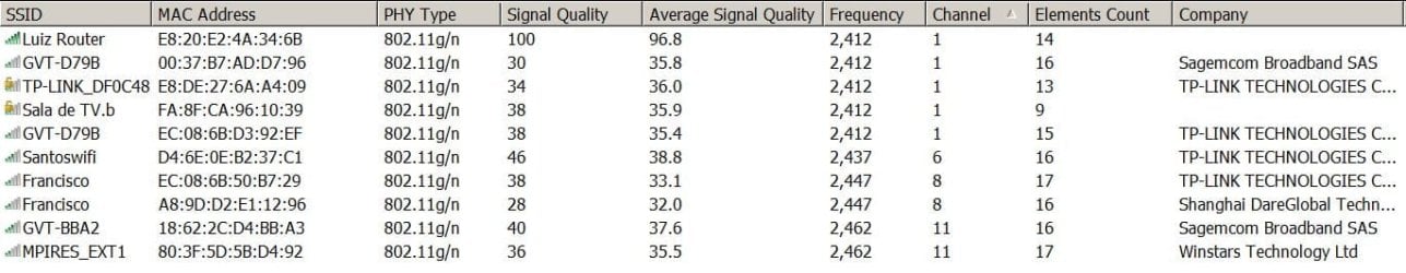

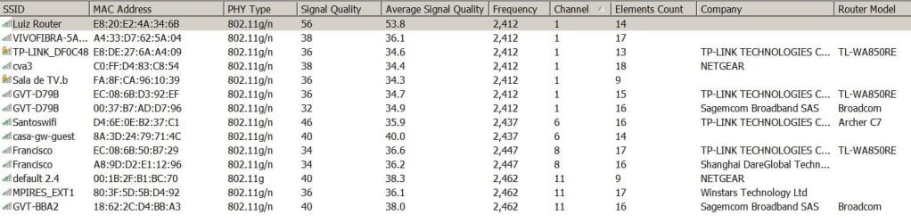

Made some changes to the Router (MAC filter ON and Bandwidth from 20 to 40MHz)
Thank you Roy and Iko
