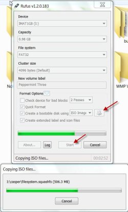

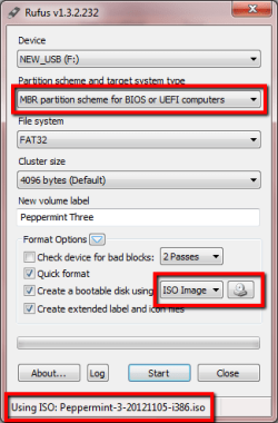

Replicate the settings shown in the Rufus panel below. Use the CD icon to browse to the location of the PepperMint5 ISO, and confirm that correct ISO is selected as shown at the very bottom of the panel.

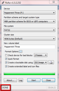

Click Start, and then OK on the warning pop-up to write the ISO and make the USB flash drive bootable. Once complete, a confirmation message is displayed, as shown below.
You can now close Rufus and unplug the USB flash drive. You have now created the Live PepperMint5 Linux USB.

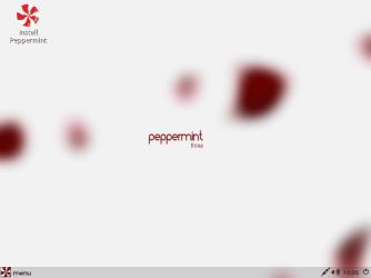

PepperMint3 will now boot to the screen shown below.

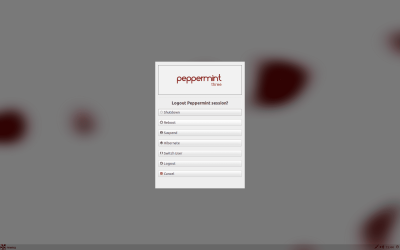

When you are done copying, close the file manger windows, and then select the Logout option from the Menu button. Now select Shutdown as shown below.
