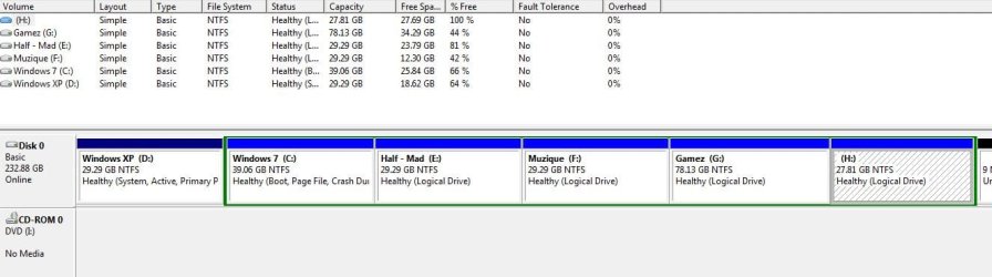

Please post back a screenshot of your full Disk Management drive map, using Snipping Tool in Start Menu, attach file using Paper Clip in Reply box. Then we can advise the exact steps to do what you want.
Do you want to replace Win7 with Vista, or do you want to add a third partition for Vista? Make it clear what you want to do.
this is the picture of my disk management
yes i want to install vista on the partition im having windows 7 installed :(
Boot the Vista DVD, select Custom install, select C partition where Win7 is now installed, use Drive Tools (advanced) to format first, then install Vista there. It will update the MBR in XP to make a dual boot.
If you want to install Vista to the empty H partition, it will configure a multi-boot with XP and Win7.
In either case you should not lose the ability to boot XP as it will retain the MBR. If an OS is missing from the boot menu, we can help you add it using EasyBCD 2.0
