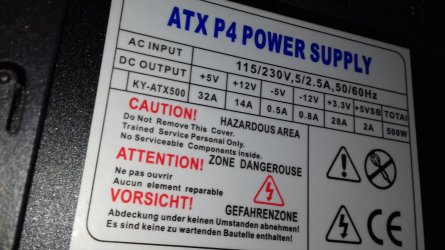

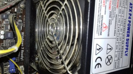

Right i have an update to this now, it`s failed on me today when i treid to start it up i held the power button and it went back off i did it again and the unit stayed on but i noticed the fan was off, so i went to take a phot o of it but it had started - i have 2 photos pf said power unit (as for variable soeed i have no idea) andyway i hope this new information helps

What I see is a very, very dirty power supply.
what I don't see is the brand name of the power supply.
your power supply appears to be a low budget (no name) power supply.
Your spec say your system was custom build. By who?
You have a very old system and it appears a very old power supply.
I'm as positive as I can be that power supply is not capable of posting a error code.
Now you seen the error code so something posted the error code.
Have you run scans with your security programs?
If so what was the results?
Jack
P=IxE
14 amps multiplied by 12 volts equals 168 Watts :rolleyes: If it's several Years old it prolly can't push 150 Watts now.
Do Yourself and Your PC a big favor and get a Name Brand PSU that is rated going by the +12 Volts Amps only.

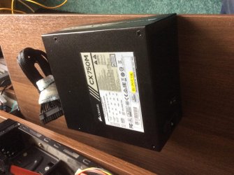

If you get a PSU now that is suitable for your future, (new PC), needs you could use it in this PC until you are ready to proceed with the new build. A new PSU should be fully backwards compatible but may need a few adaptor cables to fit correctly

My pcs new power unit futureproofed for the new build pc.

did that fix it?

Yeah it seems to be running better

At this time I recommend not doing anything more.
Use your system with the new power supply for a while and see if their are any more problems.
Did you do a basic cleanup of your computer? The computer gods like things clean and neat.
