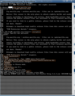

If you think it may be your browser causing the corrupt downloads, you can try this method to download firefox:
Open an elevated command prompt
(Start > Search > cmd.exe > Ctrl+Shift+Enter)
Type the following commands in order, pressing enter after each one and waiting for the previous command to finish before starting the next.
FTP ftp.mozilla.org
anonymous
[email protected]
HASH
cd /pub/mozilla.org/firefox/releases/latest/win32/en-US/
BINARY
lcd c:\
mget *.exe
yes
(Now wait for the # (hash marks) to stop.)​
Note: Downloading through command prompt may prompt your firewall to ask for permission, just say yes

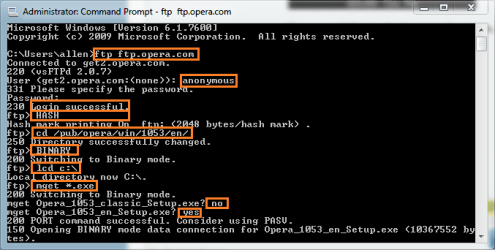

If you would like to do the same for opera, use the following commands:
ftp ftp.opera.com
anonymous
[email protected]
HASH
cd /pub/opera/win/1053/en/
BINARY
lcd c:\
mget *.exe
no
yes​
