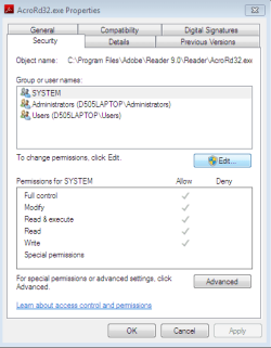

Right click the EXE program in question, select Properties, then Security. Next click the Edit button:

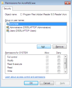

Click the Add button:

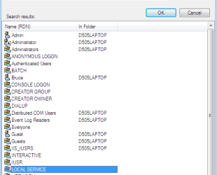

Click the Find Now button:

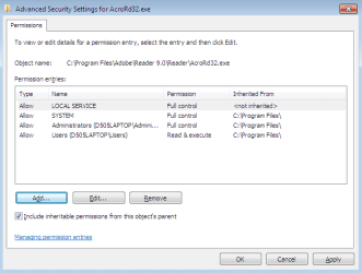

Select Local Service and click OK and give it full control:
No guarantees this will fix your issue. This is a way to add the Local Service which is what the instructions you posted said to do.
