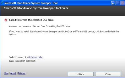

I follow the tutorial you provided to create standalone system sweeper on the flash drive ; nonetheless , there is an error massage occurs.
Due to suggestion from help hyperlink https://connect.microsoft.com/syste...x_x_x_x_x_x_x_x_x_x_x_x_x_x_x_x__Toc290622872 indicated that
Failed to format the selected USB drive
oCause: Creating the USB bootable media may fail if the USB drive cannot be formatted.
oSolution: Try to use a different USB drive. If this does not work, try running Microsoft Standalone System Sweeper Beta on a different computer or reformatting the USB drive using Windows standard interface for formatting.
Regarding to solution, I have no more system or usb drive supported but tried reformatting the usb flash drive in window interface many times still show the same error; however, .iso file could be created yet I have no optical drive , are there any suggestion or alternative way to create bootable usb , please ?

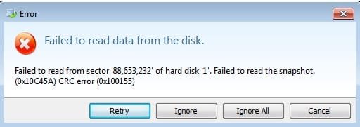

After clean installation , backup job (by Acronis) also could not be performed as a consequence of Error shown as following while “ harddisk 1” is referred to “ FreeAgent drive” according to diskmanagement which conflicts to HD tune result, any idea why?

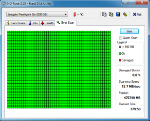

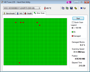

HD Diagnostic long test are run in window environment and bring about the following snips:
Are there any approach to determine in which partition or what files are situated at the damaged block ? ( I just think about austlogic defragment which could identified the data on the fragmented blocks) likewise , are there any method to amend the damaged portions, please ?

I recheck Acronis found that Acronis might counts the drive different from window ; therefore , the error is focused on internal HD.

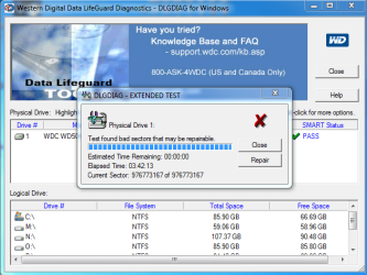

Additionally, I ran W-D Data Lifeguard Diagnostic extended test also fail while repairing bad sector .
Are there any suggestion , please ?
edit : At unit serial No. represented from
W-D Data Lifeguard Diagnostic extended test , is that the manufacturing HD serial which is unchanged after format or volume serial which alterable after each format , please ?
