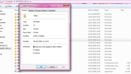

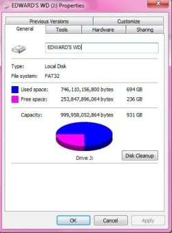

Cannot see my files on my external hdd, i think because of a virus.
I tried everything i know.
Malwarebytes
Superantispyware
Avg anti virus
Spybot
Cmd attrib ...
REgistry changes
Folder options
ccleaner
auto run exterminator.
I know the files are there because it shows my external drives half full like it before and now they are just hidden.

WD External usb Drive 1TB use it to store all my files since I use on different computers but haven't moved for couple months so its not that.
2 Internal drives unplugged one. Just realize could it affect it?
It has been the same letter since i plugged it

fixed the problem. All I had to do was unplug it. Plug it back it scan it for for bad sectors and 10 hours later done
Thanks anyway
