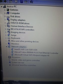

sundeep b ..wireless card isnt in my list on the device manager????? this is what i have when i open it i attached it to this post on what you see when i open my device manager..

Wireless card should be listed under Network adapters in Device Manager by the name Intel(R) WiFi Link 5100 AGN.
