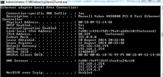

I'm a little bit confused now. It was mentioned here that I should try to connect typing in my work laptop my internal IP. I wanted to check what it it and apart static IP from my ISP(80.229.xx.xx) I can't see here what is my internal IP. Could you clear it up for me please? Which one is it? 192.xxx.x.254?
