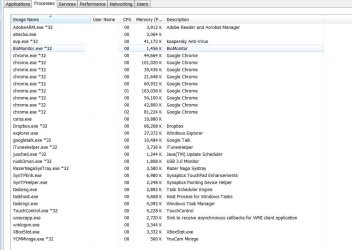

I have attached a screen grab of my processes running. Do need some help as this is a HUGE annoyance. I cannot find my re-install disk that came with the laptop so some help would be AWESOME! I might have a restore point from a long time back.

One thing for sure, in that picture you have too many instances of Google Chrome running, may be impacting resources available. If Chrome seemed to be actually closed when you did the screenshot it could mean Chrome isn't removing itself from RAM when it is closed.
Microsoft
Microsoft
Nah that's just the tabs I had open when i took the screen grab. Am doing research trying to match something with the process and issue. Along with my e-mail. Google chrome is not the issue (that i'm aware of) as I've run these programs with about 10+ tabs running. If I close Chrome it empties out from the processes just fine.
(I get a little tab happy sometimes)
On that note for some reason 1 tab of chrome is generating 4 processes.
Just an FYI; The behaviour described is completely normal and the reason for multiple Chrome.exe processes being listed in the Task Manager is that each Chrome tab, extension and plugin in use is treated as its own individual process for security reasons and so that if one tab crashes, your whole browser does not crash.

Threads 1237
