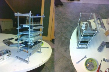

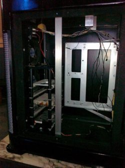

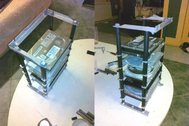

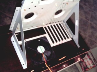

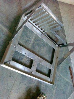

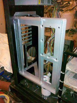

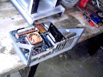

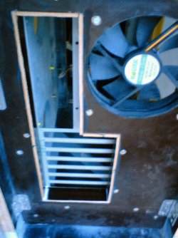

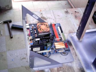

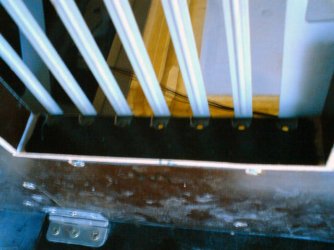

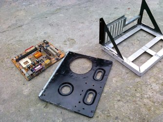

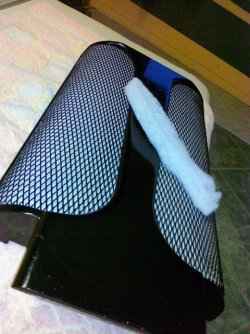

Here are some of solutions /replacement on my project if it helps.
pic 1-5 motherboard plate & back pannel
pic 6 - fan connector plate
pic 7-8 hdd ( 8 black in between hdd's is rubber pipe screws only on top/bottom)
pic 9-13 new stronger motherboard plate
pic 14 filter
pic 15 finished empty case
Just make sure every component is grounded with each other.
pic 14 filter
