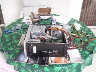

If you want to put ANY GPU in, you will need a new PSU. 300 Watts is just not enough - unless you want to set the house ablaze. And as was said, 550W is the minimum. I would even go with 650W from a reputable company like Antec.
It's fun to wrestle with the wires. Here is when I did it last.

Nice one Wolfgang :D

Thanks Drew.
Dang I gotta start spreading some rep. I can't rep either of you guys as I've not spread enough around. :o
Anyway really nice post :)
