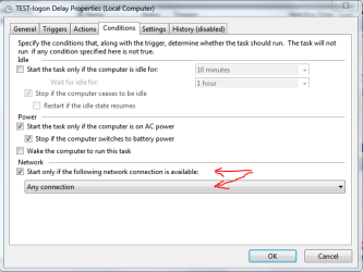

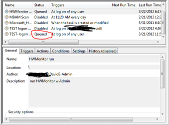

I did some testing for this and what i found is the scheduled task would run, and the delay worked.
In Task Scheduler I could see it queued upon log on, and running a short time later.
I could see it running in process explorer.

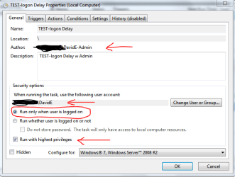

The problem was the IE window was not visible.
This may be why it didn't work for you...
It seems "Run only when user is logged on" must be checked for the window to be visible.
Why is a Windows 7 scheduled task running hidden? - Microsoft Answers
I logged in with my Admin account to set it up in task scheduler.
I set it up to only run when my STANDARD account is logged in.
So, I'm not sure if this approach is something you want to pursue, or it's too complicated.

The screen prints highlight settings i used.

I don't know...
For me i can login, go to the Task Scheduler and see it is Queued.
A minute later it runs and opens IE.
