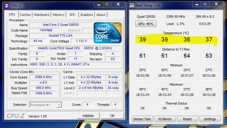

Notice that the processor isn't under load, and that the temps are only 3 degrees apart from highest to lowest. Given that i'd say there's no problem there.
I seen as much as a 6 degree delta and things be fine....

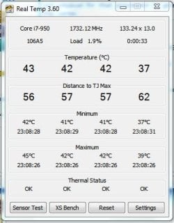

I have always wondered about mine:

I've have those as well and found that if the first core is way off like yours is, re-applying the thermo paste may be in order.
Or as some have said, you might have a stuck sensor. You can check it by clicking the sensor check tab.

Have done both, and it's always been like that.

IIRC, 'core 2' was always my 'accurate' idle sensor. Core 4 was permanently stuck at 47c under idle conditions like yours Dave.
As long as they move under load - there is nothing to worry about.
The CPU (tcase) sensor should remain unaffected by the stuck sensors.
As cato mentioned, the Q9xx series were renowned for sticky/stuck idle sensors.
