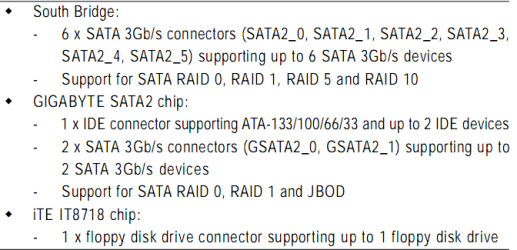

I am planning to set up RAID but cannot figure out if I need to load drivers at install of the OS or not. Does anyone know if you need to install the driver or not? I guess I could do it just in case...it's for a GA-EP45-UD3P Gigabyte. I guess this pic confirms I have on board RAID support right?
I had to sign up to find this but here is the "checklist" for anyone with the same question.
http://forums.tweaktown.com/f69/about-install-raid-ud3p-quick-checklist-31784/

If your chipset is ICH10R, you have to go to BIOS setup when bootup press "delete" key to go into BIOS and enable "RAID" on the sata drives, assume you had more than 2 HDD. then exit BIOS and during bootup when Intel Matrix driver come up , press together "Ctr+I" key to go to Intel raid setup and setup your raid as 0 or 1 or 5 (if you had more than 3HDD) then during OS installation you have to press F6, to install the drivers.(assume install XP)

nate42nd you will need two or more identical drives in order to setup an array. Your system specs show a 500 and another 640gb drive not a matched pair of one or the other. When you two identical drives in for a pair depending on how you plan to set things up.
If you are planning to use those two it wouldn't work out due to the size difference between the two. For adding another identical pair in Sata ports #3+#4 with the first two if OS drives would see the new pair plugged into those or ports #5+#6.
You can't use something like Port #1 with port #3, 4, 5, or 6 being the primary master with Port #2 as the primary slave. The remaining are secondary master/slave combinations in pairs. The pairs go in 1+2, 3+4, 5+6.
For more then two drives in an array you would use Raid 5 not a mirrored array seen with a pair only requiring a third identical drive. Two of the three would then be available for the OS, programs, and data for general use with the first one set as the default boot device. Any other drives should be unplugged when installing the OS to avoid boot information and files going to the wrong drive.

Thanks guys. I plan to get three SDD 128GB Patriot Torqx drives and use those. I don't think I need to install drivers at install of Windows 7 (but would for XP) for RAID. Thanks for the tips on the SATA ports Nighthawk. That will help.
It looks like I have Intel Matrix Storage Manager as an option to set up "software RAID" Can anyone confirm this?
It says to start Windows then go into Intel Matrix Storage Manager and set up RAID. This is not the same as "hardware RAID" as far as I can tell....
