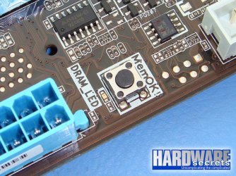

Ok, lets start with the Ram, you can look at my specs, we have similar setups. ASUS uses its MemOk! feature to help ensure memory compatibility, it's a physical switch that will automatically tune memory to fail safe settings in the event of memory errors or corruption.
To activate this feature all you need to do is to push a button located near the main motherboard connector for a few seconds after you turn on the computer until you see the red LED next to it start blinking. Then the motherboard will check if your memory modules are compatible with your CPU and will display a message on the screen after some seconds. If this LED is permanently turned on and the system does not show a message even after you wait one minute, then your installed the modules on the wrong sockets, your modules are not installed correctly/have bad contact with the sockets, they are incompatible or they are damaged.

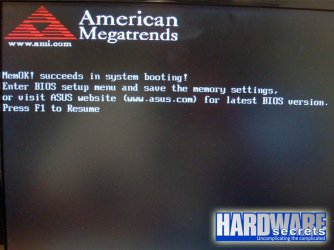

Then the BIOS screen will show this:

I pressed the MemOK switch on startup., it flashed a couple times then the screen came up saying that the memory has been set correctly also but windows failed to start because of the above error.
