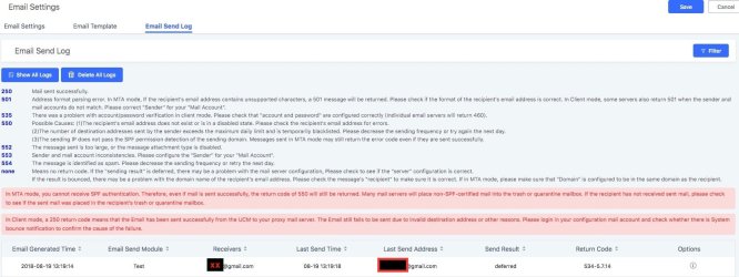

As recommended by Grandstream, I tried "Both" as the Protocol. This resulted in a failed "test" email attempt by the Grandstream UCM6102 Router:
Email Generated Time Email Send Module Receivers Last Send Time Last Send Address Send Result Return Code Options
2018-08-18 13:07:00 Test [email protected] 08-18 13:07:04 [email protected] deferred 534-5.7.14
Setting the Protocol to UDP gave this result:
2018-08-18 13:05:04 Test [email protected] 08-18 13:05:09 [email protected] deferred none

Have a look at the attachment-screenshots.
Any other thoughts or suggestions?
