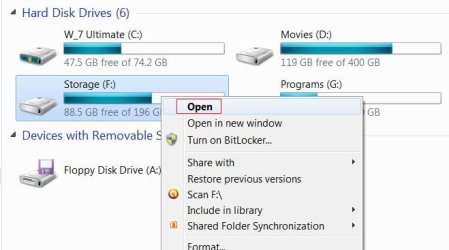

Hello Karen.
Click the "Computer" button in the Windows start menu to open Windows Explorer to see if the external Hard Disk Drive (HDD) shows up, if it does right click it and click "Open" to see if you can then browse to the emails.
click to enlarge

I was able to find where the emails are on the external hard drive. But now I'm afraid if I click to restore they will overwrite the new emails that have come in since I installed Eudora again on my computer. Will the back-up just add those files to what is already on the computer, or will the new emails from today and last night be erased in the process?
