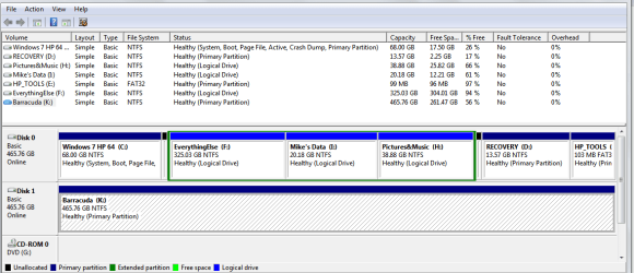

Please post back a screenshot of your maximized Disk Mgmt drive map with listings, using Snipping Tool in Start Menu. We'll give you the failsafe steps to recover the Recovery partition HD space into Win or wherever you want to put it.
Thank you Greg
Here is the attachment
I think C:\Windows 7 HP 64 please could use a bit more space maybe, please.
Much obliged.

If you don't need the HP Recovery and TOols partitions you can delete them in Disk Management and create new partition(s) in that space.
If you need to expand C then it will be a little more involved but doable with free Partition Wizard bootable CD. Let us know.

Easiest will be to delete the Recovery and Tools partitions to create a new partition there or add them to H.
If you want to add more space to C, boot free Partition Wizard CD, rightclick on F to Resize, slide its right grey border to the right to free up space on its left., click OK.
Next rightclick C to Resize, grab and slide the right grey border to the right to take up the space you made from F, click OK. Apply all steps.

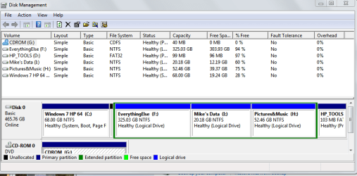

Recovery partition now absorbed by H:\
Decided to keep HP Tolls as only 200MB.
Left C:\ as it is for the moment.
Attached capture1.
Thanks again Greg, much appreciated!
