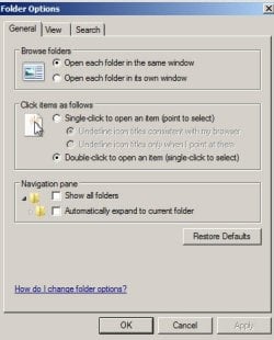

Can I assume your registry suggestions do more than the "restore defaults" choice in tools/folder options as shown below? I tried that with no improvement.
I remember fighting this issue and the "BagsMRU" registry thing from prior OSes. Strange that it remains a problem since the XP days.

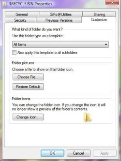

I have just come across this problem and found my deleted files showing as tiles every time I opened the recycle bin, I tried to follow ignatzatsonic's instructions to fix but without an image it makes it hard, I could not find the “optimize this folder for” option, I have included an image to show that it is not present!
What I did do was click the "Restore Default" button and that seems to have fixed my problem so i thought i would share the information for others to try.
