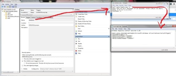

I went to lower the UAC and it was already on "never", then I went to add /s and wherever I added it, no change. Attached you'll see a picture of my scripts. I'm sure you'll see the error right away, I'm trying to learn my batch and VBS scripting. I want to load "auto_login" then shutdown, while giving myself a way out if I need to work longer.
