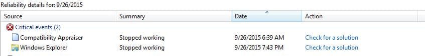

I had Google App do something funny on me today and look around and found out my computer been having two problems but I didn't know what the issues are. So I look in my Reliability Monitor and found two problems
Compatibility Appraiser -> I think is from an update and uninstall all Windows 10 stuff.
These updates --> Stop Windows Telemetry/Tracking/Upgrading to Win10 « alaya:techne
So I believe this to be fixed.
Windows Explorer - This one is a little harder I think.

No I don't want windows 10 when I copy and paste a folder to another location it just crash again on me. So it a yes stuff is give me some problems. As I have already disable all the install Windows updates that all try to download Windows 10 way before it came out in July and been not installing other updates some got through but I fix that with the link above and all when I got all the installs gone. So with that all gone I'm still having problem. So explore is crash randomly.
