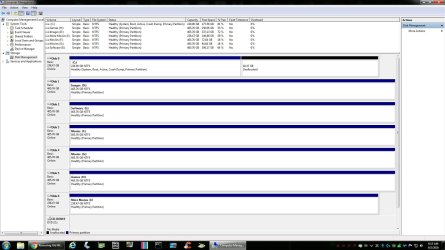

No I did not. Windows 7 was installed with just the SSD connected..... nothing else. I just wanted to make sure that if I formatted the Old partition that Windows was on it would not mess with the other 2 partitions as it will be removing the old MBR and I still need access to those other 2 partitions.
Below is my setup in Disk Management "Click to enlarge"

As long as windows boots on its own on the ssd, then go ahead and format G.
As long as the others are not extended partitions you should be fine.
If you`re still concerned post a snip, if not carry on :)

Why are Disk 2 and Disk 4 marked Active ????
If they are just data drives they should not be marked Active.
Disk 2 and 4 are separate hard drives used for storage. If I remember correctly I did not format those drives prior to moving Data to them.

So then you should mark them inactive.
Can do..... but I be curious how the active flag got set in the first place as I did not do it and those drives never held an OS on them. Haven't had any issues with them with either the new build and old though and the bios only see's my bootable drives.

Do note that some HDD come with Active Primary Partition.
I have this Samsung 3TB (bought in June) and just check, it confirm it is stated "Active" Primary partition.
I did not do any setting or any other setting.
As i am busy with my newly bought 3 SSD which is no giving a headache to troubleshoot the real cause.
So Microbell really did nothing like set it to Active, but HDD come with "Active" being set.

Correct on both comments. After checking the Manufactures site they ship their OEM drives set up as Active Primary's.
@AddRAM
I should have made that clear in my last statement. Sorry. The bios does see all hard drives attached but only has 2 that are bootable. Since the SSD is now the main OS I may just leave them Active/Primary as I have not run into any problems accessing them and they contain some encrypted data on them that I don't want to mess with. If it works....don't muck with it...lol :p
