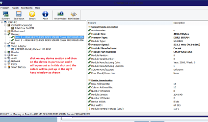

I say I am not a fan of Glary but to be honest I am not a fan of any of the software's that promise to speed things up find drivers etc the latter I prefer to get from the manufacturer rather than the less than useful I find) Windows feature. For clean up I use like a lot of us do the free CCleaner
CCleaner - Download < download from piriform.
If you are not sure of the exact device brand and model etc HW Info is very useful - see my pic for an example. HWiNFO, HWiNFO32/64 - Download < just make sure you get the right bit version.
