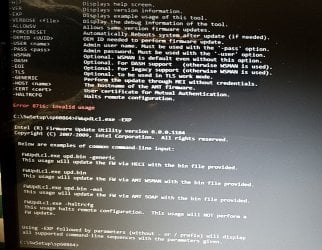

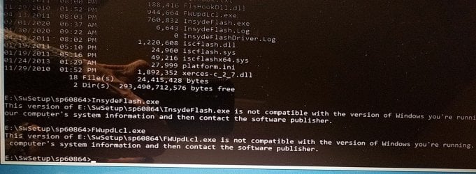

Couple of images of the display, showing option switches for a one of the executables. To reiterate what I posted earlier, there is no executable directly downloadable from the "Drivers & Download" page for this DV7 which runs under Setup/BIOS - no such option showing in the current, originally-issued BIOS.
I'm going to hazard a guess that if I were to reinstall the original recovery partition and run from there, the Insyde run-under-windows would work... maybe. I don't have that drive in my possession
See the option switches shown in the images. Does anyone have knowledge, or a link, as to the function of each, and if any of these would update the BIOS under either Windows 10 or Windows 7?
