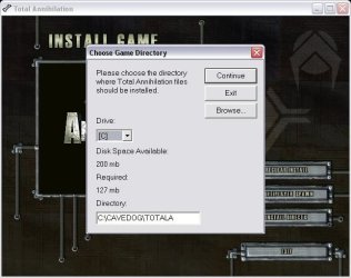

I also had problems running TA in windows 7. Started off with windows 7 Home premium. Tried to run the disks. Disk 1 loaded with no problem. Wouldn't load Core Contingency or Battle Tactics. Tried to transfer TA files from my old xp desk top via usb stick. Everything would transfer except the CC files. Even trying the compatibility mode wouldn't help. Upgraded to windows 7 professional hoping using the xp mode would work. loaded everything again in that mode. Everything loaded but had problems with Dir x when tried to launch. Got an all-in-one download from War Zone. That version worked on my computer but was always asking permission for access and would not launch in the game room at Warzone. I was ready to try Dual booting my computer with XP.
My solution that worked for me: There is a file called "Program files (x86)". This is the file for all 32 bit programs. When downloading TA disk 1 it wants to create a file desination. Choose browse and select Program files (x86). Load disk 1 to that file.
I wasn't able to run the CC and BT exe. But I was able to transfer the files from those disks to Program files (x86). I was also able to transfer any file from the usb stick with no problems.
The program started with no problems. Didn't ask for access or anything. Started just like it does on XP. I am also able to play on Warzone without any launch problems. Hope this helps.
