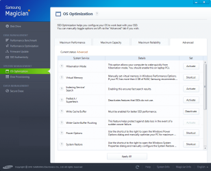

Gary, while you have Samsung Magician open, go to OS Optimization and take a snippet of what your settings are. Also, have you changed anything recently, and then noticed this problem?
Probably wouldn't hurt to run the Performance Optimization either, if you haven't already.

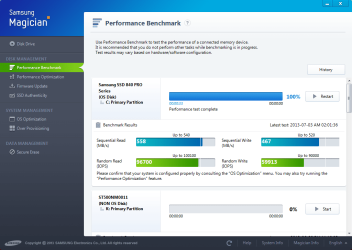

Yep, mine is just like yours Steve. Here's the Speed test, the Sequential Write speed was over 500 and Random at 90,000 when new, 4 days ago.
and after about 8 hours idle.
I have just installed it Kelly and I've run the Perf Optimization 4-5 times. It started losing performance within a couple of hours.

When you run the benchmark, are you getting good numbers again?

Sequential about the same, random falling way off. Nothing installed or any changes.

Gary, also if you run a lot of benchmarks in too short a time, it will slow the SSD down. Try not running benchmarks for a couple of days and see if the numbers go back up.
