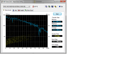

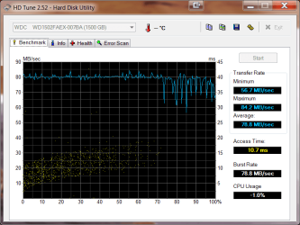

For the benefit of the naysayers, who said that connecting a SATA 3 drive to a SATA 3 controller wouldn't have any real effect, I'm attaching screenshots. The first is with the drive connected to the SATA 2 controller of my old motherboard, and the second is with the same drive connected to the SATA 3 controller of the new motherboard.
I realize that those of you who are accustomed to SSD performance may consider this trivial, but I do not.

From a naysayer viewpoint, I think there might be more going on that the simple port that you plug into. Most drives with HDTune look like the second chart, starting fast and dwindling down as you near 100%. However, your first test isn't showing that at all. It really looks like with your old mobo, something was really limiting hard drive speed to 80MB and no more. That isn't necessarily normal with SATA 3.0Gbps. I've had speeds of 120MB+ starting on my SATA 3.0Gbps on my GA-EP45-UD3R mobo.
I'd be interested to see a speed difference of that SAME hard drive between the SATA3 port on your NEW mobo and a SATA2 port on the NEW mobo. I'd bet you wouldn't see much difference there.

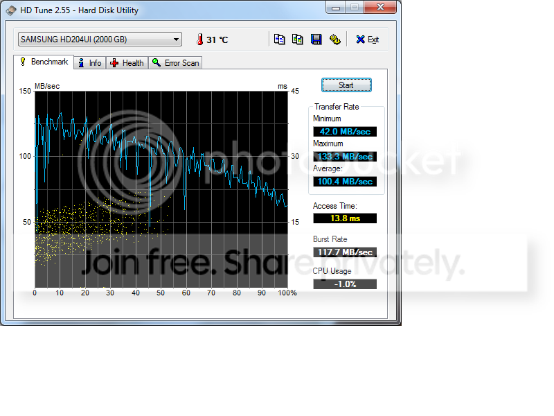

For reference, here is my 2TB Samsung 5400RPM storage drive on SATA 3.0Gbps

Sorry, no can do. All of the SATA ports are SATA 3 on this rig. The only way that I could do SATA 2 is to install a controller card that I have, but I'm not going to. I did test this same drive on that controller card, as well as directly connected to the motherboard of the old rig, and there was little, if any difference.

I understand....cannot test what you don't have.
It's good to see you get a performance boost, I'm not sure why your old mobo was really holding you back that much. But just don't assume that everybody coming from a SATA 3.0Gbps to SATA 6.0Gbps is going to see this level of performance increase that you are seeing. The change in my case might only be marginal.

There is something seriously wrong with your SATA 2 port. The plot should not be flat like that at 89 MB/s. You should see the variation in performance from one end of the platter to the other. SATA 2 can do about 260 MB/s and you should easily be able to perform at the rate your are seeing on the SATA 3 on the SATA 2 port.

It may be that there was a problem with the old rig, other than just a difference in port types, but I just ran a couple of more benches on some SATA2 drives, and they also show a marked increase in performance from before.

It looks to me like your SATA 2 port was running at SATA 1 speed.

Glad you noticed a speed increase. However, the Wd1502faex is a very fast drive and even has a 64Mb cache, so it's shocking to see the low HD Tune numbers you put up. The numbers should be closer to what a lot of us are getting today with our SATA III builds. That's the reason for the skepticism. Something was holding your drive back. Hopefully you didn't have a jumper on the drive, giving you SATA I speed. If you take a look at some of the HD Tune SATA II scores over the internet for that drive, you'll see what we mean. :)
Still.....glad you're now seeing the speed that you should have previously achieved.:)

Three little words for what was likely holding the drive back; Nforce 4 chipset. You even have a quick and easy way to test seeing as your remaining NF4 board is virtually identical to the one you replaced, just connect that drive up and run the test on it there and see what kind of numbers it gets.

I understand your comment so far as nForce 4 chipset goes, but as far as I understand, this motherboard uses an AMD chipset, and I haven't read anything relating to NF4, so I don't understand how you consider it identical to my old motherboard, and since I have tested the drive on this motherboard, I'm not sure what test that you mean?

Not the new board is the same as the new, the board you used to have was the same BF4 chipset as your second computer in your specs.
I assume that flatline result in your first post is the same drive only one the old NF4 computer. If it is put that drive in your other NF4 computer and run the same test on it and see what results you get.

I don't need to test it in the HTPC to know that it would get similar results. I don't know that it would flat line, but it would be much lower than it now is.

The most important stat on those benches is the access time and it's better on the SATA II port. Funny results.
