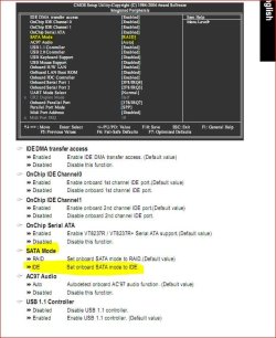

How is the SATA controller configured in the bios? If it is set to RAID the easiest solution would be to set it to IDE mode,
and then it shouldn't need any drivers. Also the slight benefit if any from running in RAID/SATA mode with a single drive isn't really worth the hassle.

it was already in ide mode and just for the fun of it i changed it to raid and still nothing

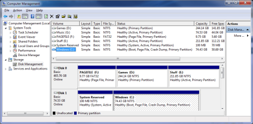

the sata hdd is my storage hdd and yes i can see the hdd in device manager but that's it.
Can you please post a screen shot of Disk Management,
so we can see what it is showing as.

i have 2 hdd's in my pc right now
1:500gb samgung sata hdd
1:seagate 320gb ide
Sorry, now I'm confused by that last screen shot. Where did the two 1 TB drives come from? Or am I seeing things?

the 1tb hdd's are externals
