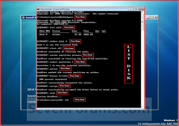

theog,
On the size disk he has, 1.5 TB a clean all will take between 12-14 hours according to one chap.
This is why I did not recommend a clean all.
As a security measure and to rule out unusual possibilities then a clean all is excellent. Clean all will write zeroes to his entire disk which is a very time-consuming operation.
Only meant as a screenshot of diskpart, to help OP.
Not to override your command line list.
