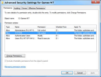

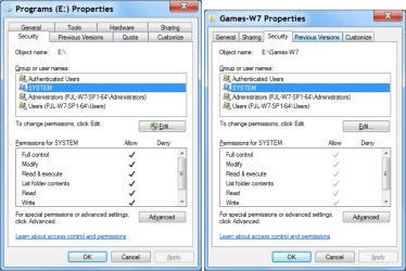

Inherited Permissions
I think that "greyed out" permissions, actually indicate that the permissions are "Inherited" from a higher level.
Notice that:
  • The SYSTEM permissions on E:\ are black.
  • The SYSTEM permissions on E:\Games-w7 are grey (Inherited). #
This window confirms that the permissions are "Inherited".
